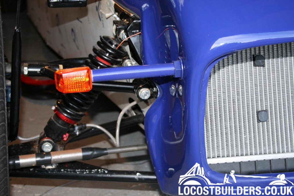

This is how I did mine...
15mm copper tube with an M8 nut knocked into each end and glued in place (could be soldered I guess). The bike indicator had a hollow M8 bolt with
the wires going through it and I drilled a hole through another M8 set screw for the end that fits to the nose cone so that the wires could go through
that as well. This was secured to the nose through an M8 hole and a couple of large diameter penny washers to spread the load. The two sections of
black tape are just to get the right diameter for a cosmetic bit of plastic sleeve (a couple of £ from B&Q), sprayed to match, to tightly fit over
the top. The blue plastic nut in the second picture is cosmetic only and is a plastic pumbing nut. It may have to come back off to meet IVA radius
requirements.
