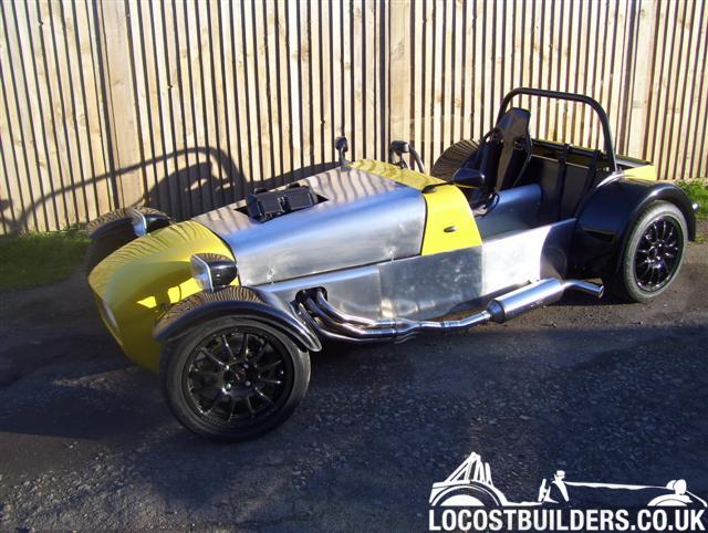

Ive got an airbox and new filter which should be good for 99-03 i believe, and if you turn it upside down you will have to cut a hole in the bonnet but is cheaper than a complete rejet, and when i did mine it worked a treat.
Not sure how much to post/send it but ill take £20 + postage if anyones interested, bearing in mind this does include a brand new filter.
Mine turned out looking like this.
