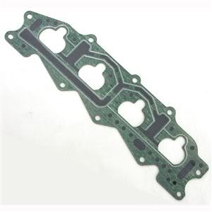

wanted Zetec (Fiesta/Escort) inlet sandwich plate manifold gasket
as im using a Fiesta RS1800 injector sandwich plate on my silvertop 2 litre mondeo zetec i need a combination of gaskets.
Im after a 1600/1800 Fiesta/Escort inlet gasket like this
But not like this

I used the one in the top picture, got it from burton power. I just used a bit of gasket compound in the channels to block them off as it is only the thickness of the green gasket paper.
