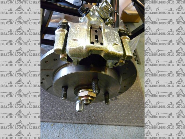

First of all you need to turn down your drive flanges to 134mm. then you buy some adapter brackets from 3GE components for £18.00
Then you buy some Sierra disks from Ebay £40
and some calipers of your choice - works out to be about half the cost that RD charge
  Rear Brake mods

can you give me a bit more info on how to get the drive flanges to 134mm
and can i use normal sierra calipers
