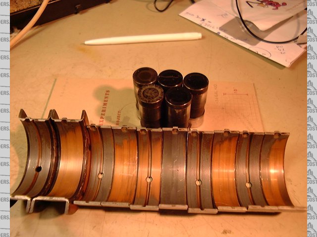

WALK AWAY from anything that is black inside regardless of how cheap it is. (Been there and done it, see pics below) Unless you are going to use it as
a part exchange!
  Stripped Head in the Garage
  Slightly Worn Bearings
