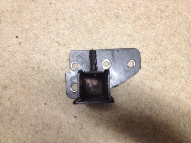

I've been putting my new zetec engine the Indy today and I need to "extend" the drivers side mount by 50mm, and passenger one by 15mm so they can pickup on the mounting plates from the old pinto. It's just not in the correct place.
I'll take a picture shortly of the mounts but rather then extend the mounts, it's probably easier to make / buy new ones - anyone got a pair that are different to mine floating around or can make me some?

Edit to include the pictures of the nearside mount which needs to be 140mm (it's currently 90mm)
This is the dimension which needs to be 140mm from block to the centre of the mounting hole.
