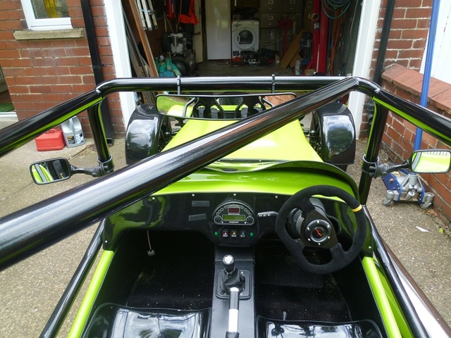

I bought some for my build. Ended up selling them and went for rocker switches which are much better quality.

Got any pictures Neil?

| posted on 19/2/15 at 09:50 AM |
Ben_Copeland
| posted on 19/2/15 at 10:11 AM |
Ah I was thinking about the metal toggle switches
[Edited on 19/2/15 by Ben_Copeland]
