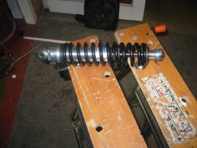

| posted on 25/4/06 at 10:11 PM |
Hi Ned.
After talkin to Rich about how he did his in a lathe, I made a couple of hook things from bolts and screwed them through the workmate. Did them in
about 10 mins. Willpost a pic tommorrow if you want??

| posted on 26/4/06 at 06:35 PM |
Heres the pic wether you want it or not
