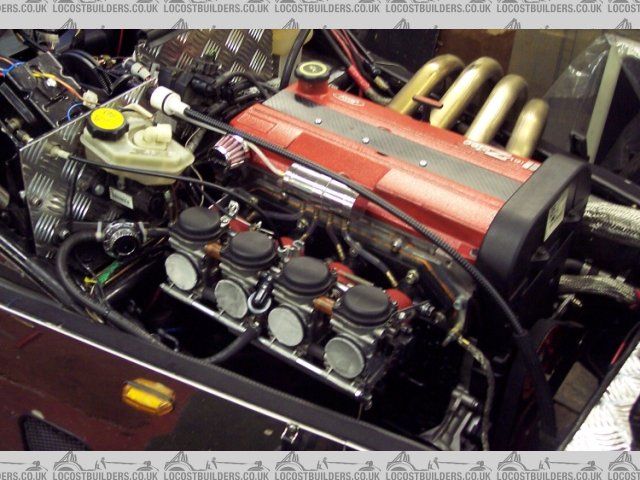

Andy, I was faced with a similar problem ie price! so I made my own inlet system to fit bike carbs onto my Zetec.
It's the same procedure for T/Bs. I used the plastic inlet manifold from a Rover K Series, then fabricated an adaptor plate from a sheet of
ally.
I've done about 500 miles so far - all works perfectly.
If you want to send me you e-mail address I'll mail you pictures of the process.

FazerBob
| posted on 12/6/08 at 06:23 PM |
pic of bike carbs/manifold
Bob
