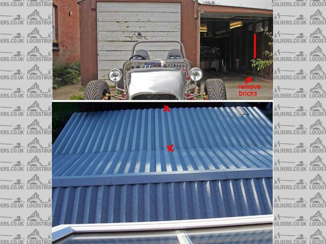

Hi JF.
Garage number 1 has an apex roof. I built number 2 afterwards and has gentle sloping roof.
There is a stud & ply wall that seperates the two with a doorway between them. The idea is
to have a dirty side (apex) for grinding & welding etc and a clean side (slope) to keep and
work on the car.
The roof is made from flat galv sheet that I folded to give it strength.
There's a row of bricks on the edge of the concrete floor, a damp proof membrain, and wood
on top of that. Vertical studs, then the frame clad with 10mm ply. The wood was pallets from work.
My plan is to remove 3 or 4 bricks and 1 stud and recess the lift posts into the wall to give me
maximum space. (Red line in pic) I may have to under pin the floor for the outside post.
The red X's in the other pic shows where they will be under the roof. (taken from landing window)

That is certainly an idea JF.
I had a measure up tonight and the existing apex is 550mm high, so could probably gain 475 ish.
see pic. Sorry for the mess. The wife's been sorting out the sweet peas.
I think the next step is to get the lift home and run a tape measure over it.
Paul G
height gain
Don't worry about the mess, I see worse on a daily basis at work. Both in the shop itself as what comes in to be fixed.
