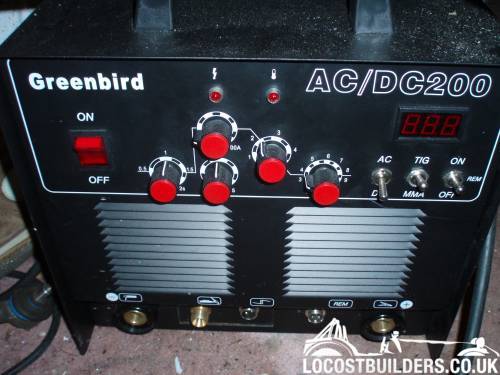

Last year, there was a bulk buy where several of use purchased the below TIG welder.
Well, I have just decided to have a go (in anger) with mine, but cant find my manual. I know which bits connect where, but, can some kind fellow tell
which knob does what 'Pre-flow, postflow' etc.
Cheers in advance,
The Baron.

If you can U2U me your E Mail address I think i have a PDF Version
Regards
FRank
Gav
| posted on 7/11/07 at 08:28 PM |
you can find it here : http://www.differently.net/files/TIG/ with a few more pdfs from the miller site for TIG welding
the manual is ACDC200aMP.pdf

Have a good look at this link as its a useful amperage calculator, and also for the gas flow / size of metal etc.
Its a good starting point for us beginners.
Getting the settings right is a large part of getting a good weld.
Linky
Also do a Bit Torrent search for "TIG Welding Basics.avi" Its a 1/2Gb long training video. Well worth watching. The bloke is a bit
boring, but it covers the subject well, and explains a lot. - Well worth downloading, and using in conjunction with the link above to the Miller
calculator.
If you are new to this like I am, its a big help.
