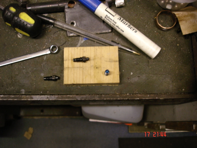

Made the bleed screw as mentioned - concentricity in the drill press is not an issue as there is more wobble in the threads. It did take a fair bit of time getting the angle pointy enough so that a ring of marker was rubbed off.
Once brakes were bled, and screw fitted, they are rock solid - no signs of leaks, no undo torque needed to tighten. As a final test I will put an elastic band on the lever for about 1/2 hour to see how it goes but the signs are good.
Caliper is alloy with stainless steel socket screw BTW.
In photo you can just about see the rubbed off marker pen. Rescued attachment DSC04133.JPG

posted on 18/12/08 at 04:14 PM Reply With Quote
Ok, I'll spill the beans.
You only need bleed screw fitted when you bleed the brakes, otherwise all that is required is for the braking system to be sealed.
Magura brakes have this arrangement.
I needed to bleed my front brake and found that Shimano bleed screw fits which I took off a bike I intend to sell - hence reason for making these. The Magura bleed kit costs £ 20 - which I will need to return; the Shimano bleed screws cost a fiver inc postage - so in the end I saved £ 30 for about 1/2 hours messing about.
