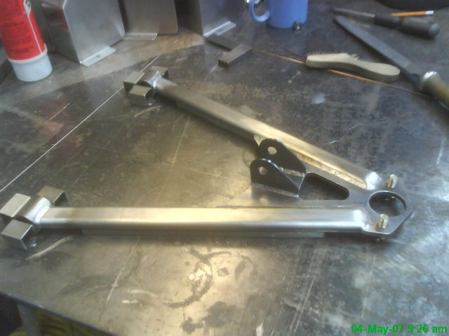

smuty
| posted on 27/5/09 at 07:58 AM |
after a bit of practice

big_wasa
| posted on 27/5/09 at 03:23 PM |
Best learn to walk before running.
God them wishbones look good
