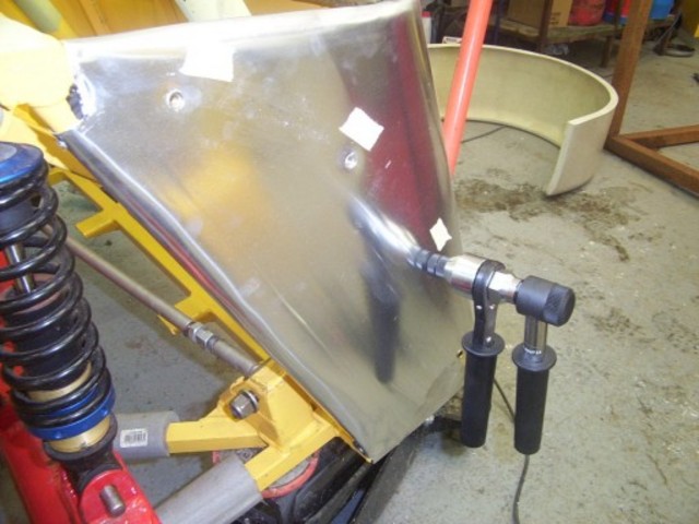

Got this for work a few weeks ago, amazingly easy to use, M4 to M10!. Will wind in a stainless nutsert in 15 sec without any effort, but it was £100!
Could be copied quite easily using an old ratchet and threaded steam pipe Rescued attachment Nutsert Tool.jpg
And if you've got access to a lathe, you could make one in the way I've described in my web pages!
Click on the link below, the 'steering wheel', then look for 'special tools and parts'. Took 1 thrust bearing (£1) and a few bits of scrap. Dead easy to set 8mm nutserts with a ratchet wrench.

http://www.nfauto.co.uk do a cheap kit 22.50 for the tool and 40 ali nuts xpensive one 62 quid an fifty nuts

We got ours from Wurth (bodyshop suppliers), but FWB do them, they are national
