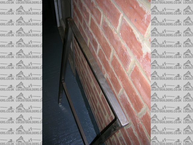

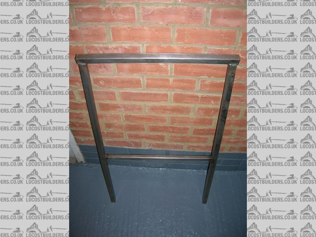

  Frame - Before clean up
Gave it rub down:
  Frame - After clean up

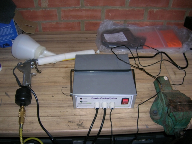

  Electrostatic Magic
I applied a coat of the powder and started to heat it with a paint stripper gun as there was no way I'd get it in my Oven! (plus ive been told
its best not to use an oven thats still used for cooking due to fumes)

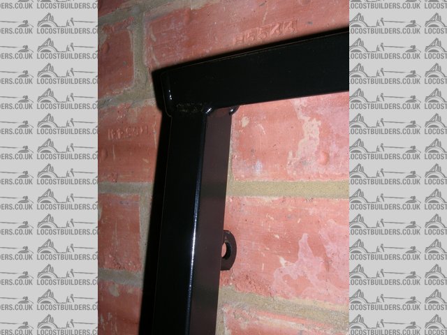

  Finished Frame
  Finished Frame Close up
Im quite please with the end result. Finish is good, and the process is much simpler than wet paint. I think I took no longer than 2 hours to do both
coatings, clean up was just a simple broom up, there was minimal waste of powder (id say i used less than a 1/4 of the bag which came with the kit
(£4.99 to buy alone) so in all much easier and cheaper than spraying.

i have a kit, think its fab. but it has limitations. youve done well to get that done with a heat gun. I always use the kitchen oven, and let it vent
for hours after use.
What air pressure do you run? I find i have to shake the gun constantly to avoid it clumping up and blocking.
will
[Edited on 14/7/10 by dinosaurjuice]
loggyboy
| posted on 14/7/10 at 12:09 PM |
I used about 20 psi (set the gauge to about 25, which gave 20 when flowing)
Didnt seem to have any issues with clumping or powder flow.
