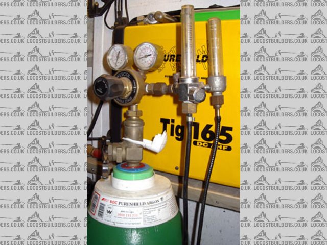

Gas Flow
Hi RPS
Guesswork was never my strongpoint, I
guessed east or west and your in north
Suffolk.
Talking of guesswork, I'd advise the use
of a flowmeter (see pic) set at 10 l/min for
accurate argon flow rate.
Us "old craftsmen" just play it on our tongue and say "'bout roight"
Anyway, I feel a bike ride coming on.
email or U2U me with your post code if
you like.
Paul G
