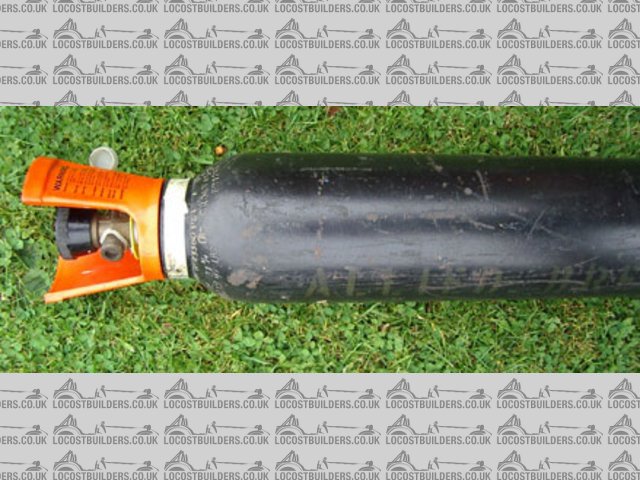

type 907
| posted on 16/6/04 at 05:58 AM |
Hi All
Anyone want an empty bottle?
Free to a good home.
Distillers/Allied Breweries, male thread.
Most landlords will swop for a full one
but it can be difficult to get hold of your
first one. I was going to get a "squirter"
but in the end bought a TIG.
Paul G
