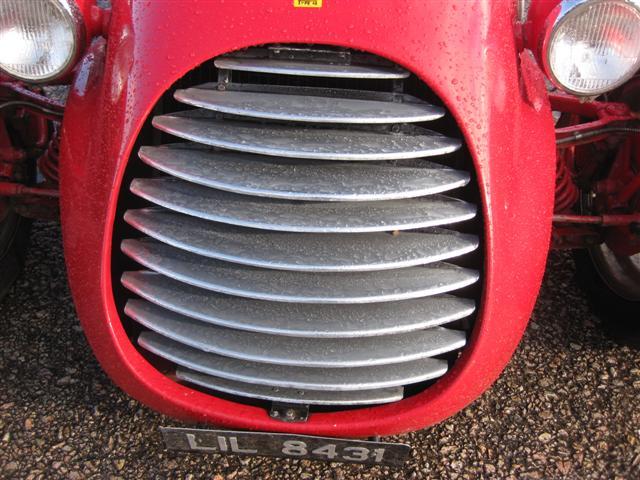

The Ferrari grille is very effective and not too difficult to make. Once the patterns for each leaf have been drawn up the regulation plywood can be
cut to shape, sandwiching the steel in this case and the edge tapped down. The back edge is turned up to the correct angle and bolted to a backing
plate; very simple but very authentic looking.

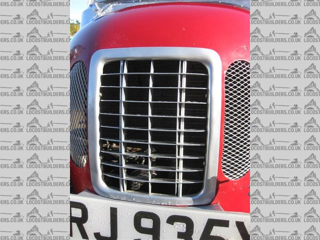

The second grilled made from aluminium has used Hammerform to form the surround.The horizontal and vertical slats have been slotted together. They had
been TIG welded on the crossovers to stop them coming apart and a pair of vertical spacers keep the whole assembly rigid. Another grille which is easy
to make but looks quite good I think.

On the subject of the photos above - I'm planning a grille quite a bit like the Ferrari one but I must admit I'd never of thought to
hammerform the individual leaves. My intent was to just cut them out of 3mm ali plate. Surely simpler all round?
Anyway, thanks again for all of your freely given information. I'll put up some pics of my own if and when I start swinging hammers.
