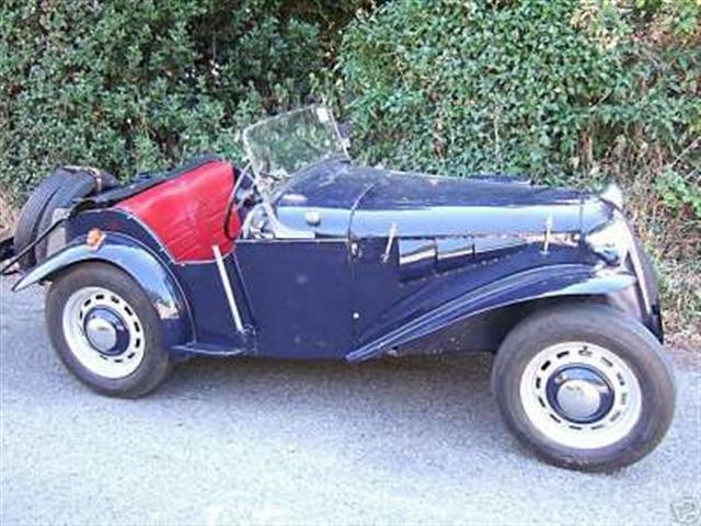

I'm sorry I didn't answer your question. The wings are for Dellow trials cars. Manufactured in the early 50s, they used Ford 10 running gear and the chasis were constructed using ex WW11 rocket launching tube. In all, about 300 were built, many of which still survive and compete regularly in Classic trials .

Strontium Dog
posted on 1/3/11 at 07:49 PM Reply With Quote
Oh, that is brilliant! It would be worth a trip out just to look at that.
You'll have to pm me your address and no. and I'll give you a bell! Now where did I put that sheet of ali?
2cv
posted on 1/3/11 at 08:15 PM Reply With Quote
Ah, sadly I don't have a Dellow. I'm just making a small batch of front and rear wings for one or two Dellow owners.
Sorry to disappoint, but you would be very welcome to pop over for a cuppa and I'll be pleased to show you what I'm up to. Do drop me a U2U if you'd like to.
