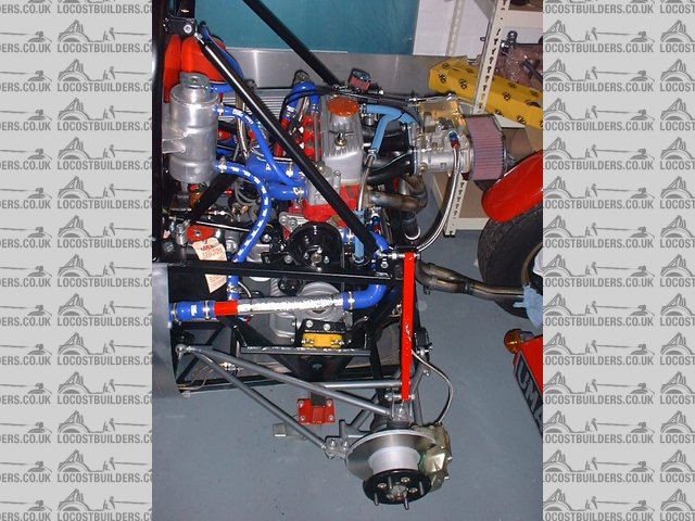

Best way to save time / effort and mistakes - I had 20 taper bushes made locally for a reasonable price. I gave them a ball joint to ensure they made
the tapers just right (enough room left to pull up the nuts without the taper bottoming.

Terrapin_racing
| posted on 23/7/04 at 02:03 PM |
There are pictures of the suspension of my Terrapin (yes Terrapin - not locost!)
suspension in the archives but the wishbones may not clearly show what you want.
Upper fronts are adapted to rose joints.
Rob

Skirrow
| posted on 24/7/04 at 06:31 PM |
Nice looking A-series.
I wish the A-series which is gonna be going into my Freestyle looked half as good as that!
