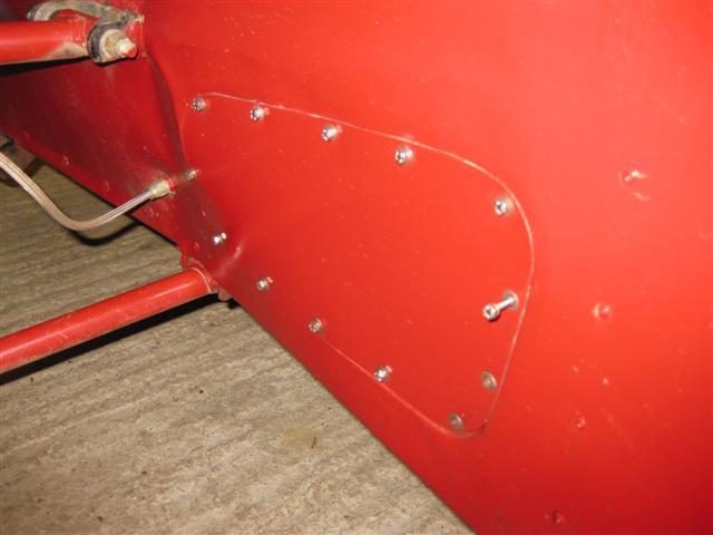

John Bonnett
| posted on 25/6/11 at 09:08 PM |
Something like this access hatch? (adjacent to the rear suspension clevises)
[img]
  Access hatch
[/img]
[Edited on 25/6/11 by John Bonnett]
