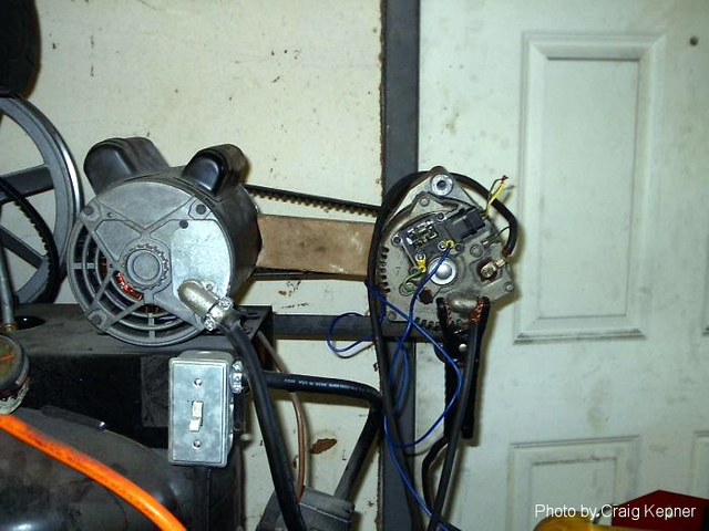

| posted on 18/3/07 at 12:55 PM |
There was a topic on a rodders forum about this
There were some pictures of what he did, like this
