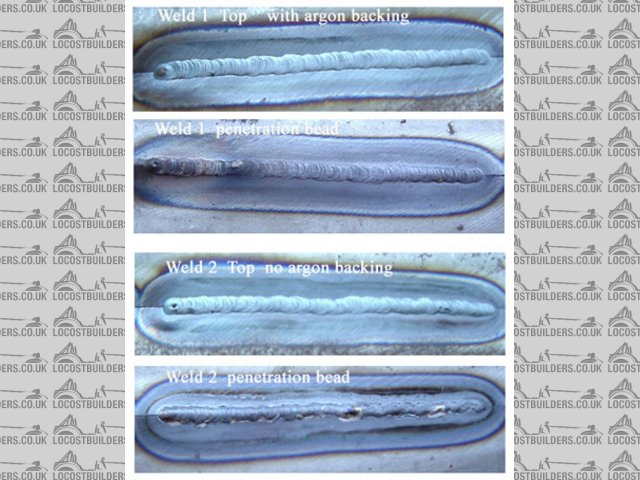

posted on 14/10/04 at 07:59 PM Reply With Quote
Argon Backing ???
Hi Cassidym,
Since "a picture paints a thousand words"
I poped out to garage tonight and ran off a couple
of welds to illistrate the benifit of
argon on the back of a weld, IMHO of course.
They are butts in 1 mm mild steel sheet.
Tig was set at 38 amps for both welds.
The joint was tacked & clamped 5 mm above a
thicker piece of plate, and for
weld 1 the gap filled with argon at 6 lt/min
For weld 2 no backing gas was used.
It is noticable in the bottom pic (unbacked)
that as the weld progresses from right to left, the oxygen is used up
(forming an oxide scale) and the appearance of the penetration bead improves.
What I can't show in a picture is how
much better the molten metal flows when
backing gas is used.
I will let you draw your own conclusions.
Paul G

cassidym
posted on 14/10/04 at 09:39 PM Reply With Quote
Paul, thanx for the trouble you've gone thro. I'm sold. I'll wait till I can afford a dual flow meter for back purging before I start.
Give me more time to practice anyways + I eventually plan to ove to stainless so I'll need to purge.
Damn, just wish my beads looked as good as yours.
