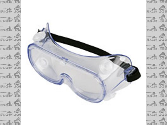

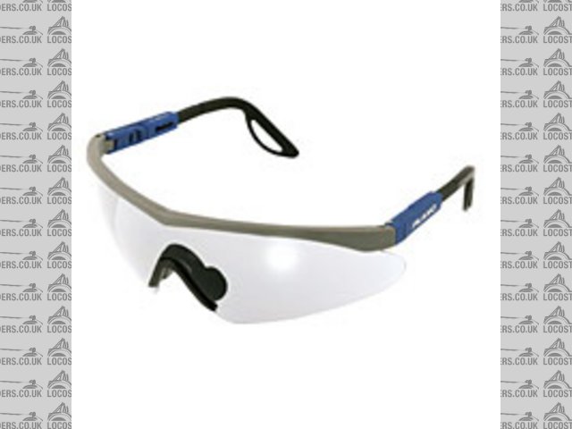

I have worked in factories where glasses had to be worn as a matter of course when on the shop floor. They give a general level of protection. However for job specific protection you will need to assess the risks and where the appropriate level of protection.
The last company i worked at was a fabrication company. For welding of course full face visors were used, however for dressing they all used visors as opposed to goggles as these protect the full face and neck area, often glasses were worn as well to protect from stray bits and when the visor was removed etc (mainly to protect from third party work which is not as relevant when working on own).
Anyone who sells eye protection should be able to assist with rishk assessment and advise appropriate gear to wear.
I hope this helps.
