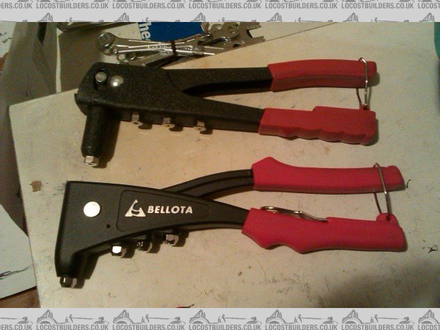

| posted on 15/6/15 at 09:43 PM |
benzine tip is what I do. Did 5mm ones with 5 to 7 squeezes. And gloves after some bruises.
Also, noticed a big difference when I moved from my cheap riveter to a more expensive one (and that had longer arms).
The old on top and new below
  old and new riveter
