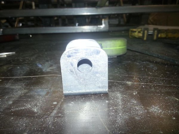

I folded mine from 4mm stainless on my 16g folder.
