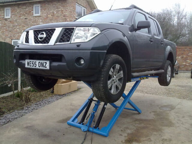

ReMan
| posted on 9/11/23 at 10:31 AM |
Same with tyhese type of lifts.
Seen many at fairs etc, and Id be ok using them to do the brake or change a tyre, but just not sure i'd want to be under one with 2 tomes of car
and an unknown weight distribution
https://www.ebay.co.uk/itm/235276028991?var=0&mkevt=1&mkcid=1&mkrid=710-53481-19255-0&campid=5338268676&toolid=10044&customid=
Cj0KCQiAo7KqBhDhARIsAKhZ4ujuGcnj9kPkxY553AvRu0ym9x9Gi3VB-AcJzjafMggYKh-nk-y3vfcaAj95EALw_wcB
| posted on 9/11/23 at 12:39 PM |
Well that doesn't look stable at all -
A heavy front end and a light pickup bed, huge moment and a small footprint on the ground. Bare minimum that should be solidly connected to the
ground.
coyoteboy
| posted on 9/11/23 at 12:43 PM |
Having hoiked my 370 up on a 2 post lift and found it massively nose heavy, those scare me. And that's a car that is meant to be close to 50:50
distribution.
