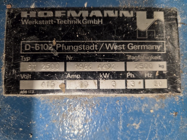

Was lucky enough to have been gifted a Hofman GT2500 ramp a few years ago.
Finally at the place I can do something with it but don't have three phase, nor is it viable to get three phase installed.
Any ideas on best way forward to getting it working? New single phase motor, or inverter? Have a 40A feed into the garage and 32A circuit I can connect it to.

stevebubs
posted on 3/8/25 at 01:03 PM Reply With Quote
Seems a minefield...
Any suggestions based on the motorplate above?
415v / 10A / 3KW
