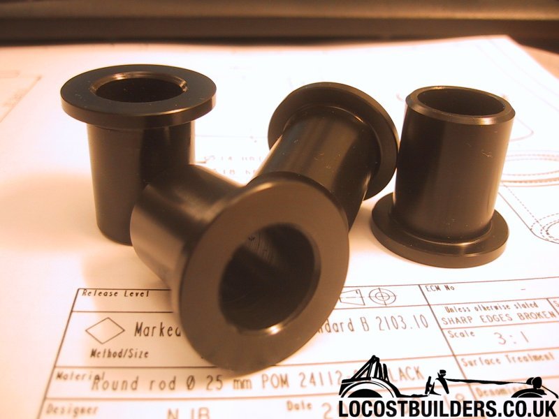

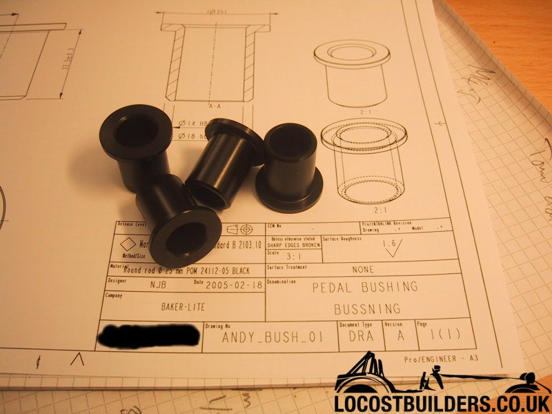

| posted on 18/2/05 at 03:44 PM |
Hey Andy..... Here you go fella, I just knocked them out for you. U2U me your address and I'll pop'em in the post
http://www.locostbuilders.co.uk/upload/bushings_1.jpg
http://www.locostbuilders.co.uk/upload/bushings_2.jpg
Edit: The bores and outsides are H7 and h7 tolerances respectively.
A satisfying half half hour
N
[Edited on 18/2/05 by nick baker]
