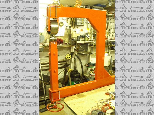

Wheel

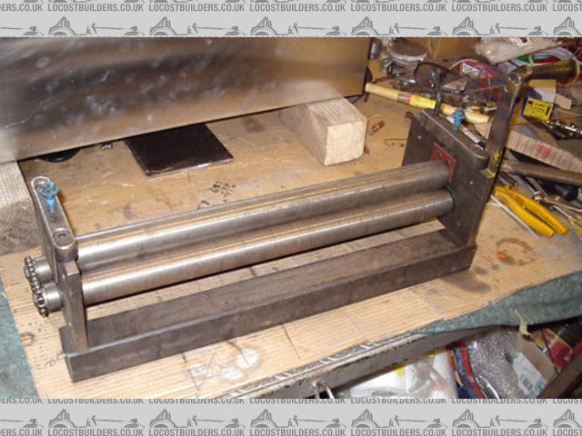

rolls

For anyone looking to get into banging out shapes in sheet you can build your own shaping/planishing hammer out of some square stock and an old air
hammer and a air valve. Make a frame similar to 907s english wheel frame but instead of the wheels mount the airhammer and an anvil (old hammer head
or something) Use an air flow valve and mount to a foot pedal.
Gets you something like this for about $30
http://www.tinmantech.com/assets/images/kent_w_airh_lg.jpg
Great post guys.
