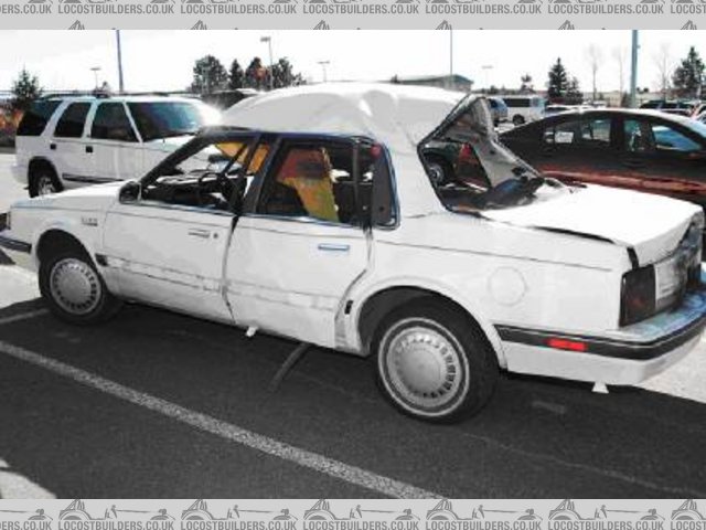

In this car teens took a balloon full of gas to frighten the neighbours, it rolled across the front seat, static ignighted the balloon , the gas detonated.
Al three suffered shrapnell wounds and punctured eardrums.
A bit different from LPG
