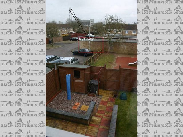

Powering my garage
Something that's been bugging me since deciding to build a my MNR Vortx is that my garage has no power.
It's a rented en-bloc garage so everything has to be undoable and I don't think drilling through the wall is an option!
I can't see a way of permanently running power so everything has to be set up to allow me to unplug the garage of a late evening.
  Garage
I can easily run power to the shed, but I need to make sure it's safe. There's a 13amp socket on the inside wall in the bottom left of the
picture. My thoughts are to run a spur from that through the wall using armoured cable and terminating it with an IP65 waterproof plug socket on the
side of the shed.
It's there I get stuck, I've got some of this
that I can use to cover the cable over the path.
and then run the it to a small RCD consumer unit in the garage.
I'm only looking to run lights and possibly a small compressor (air riveting and an air gun).
I had thought of going the generator route but I don't think I can stomach a constant 65db in the garage from a quiet 2kw generator!
Are there any other options I hadn't thought of?

That streetlamp behind it looks very inviting . Do you know anyone who works on the waltzer .
mangogrooveworkshop
| posted on 25/3/06 at 11:45 AM |
I would have a temp extention lead that would sit on the fence when using it chucked over the roof. A fairly heavy cable will do and put down two
cones where you stick it cross the path.
We do cables like this all the time and BT do it all over the countryside but leave them for years. As long as you dont leave it overnight and the
trip hazzard is clearly marked you should be ok.
That streetlight is a good candidate for supply not that I would ever do anything like that

From what I can see, the correct answer is, you can't. At least not without putting yourself at risk of litigation by carrying power over a
public area and the possibility of someone injuring themselves on it.
A generator would be the safest option, it will also save you having to mess around with extension leads every time you want to spend any (night)
time in there.
Good luck

Drill through the wall man !!
If you do it through a mortar bed it will be easily undoable.
I would be tempted to bury an armoured cable right under the edge of the tarmac area as well. Couple of hours with the right tools and materials
would have that done. Protect it with the appropriate breaker at the supply and you're done.
I mean, it's not like you're digging the road up or closing it.
| posted on 25/3/06 at 12:37 PM |
Agree with Zilspeed , a small hole through the wall which could be plugged with a bit of mortar when you have finished , a trench a couple of feet
deep to be on the safe side , a trip and isolator switch are a must .

It might be safer to put a 110v site tranny in the shed, and power your lights via an extension from that, you could even put the compressor in there
as well and run an air line to the garage, not ideal but at least if some dopey kid cuts the cable whilst your working they wont get a belt. If you do
run power to the shed it should really be protected by a 30ma RCD.

I am an Electrician.
Use an armoured cable. Try and get your neighbours approval to run it on their fence.
Running a cable along public property is highly risky. Burying it is even worse because people do not know where it is if they carry out ground
works.
You also need to install an RCD BEFORE the cable and not in your garage as you suggested.
If you tell your neighbour that it is temporary, eventually it will probably become permenant !

think the issue is the slide bit is public property.
ReMan
| posted on 25/3/06 at 01:41 PM |
Ts not the neighbours fence its a public/council fence as I understand it
www.plusnine.co.uk
chockymonster
| posted on 25/3/06 at 02:17 PM |
The garage is rented from the housing assoc, the little fence and playground is council property. There's a small patch of grass on both sides
of the little fence which is again council owned, the road is public highway.
Between the playground and my fence is a paved path that I can't dig up and it's got a concrete base (not that I've lifted a
slab)
I think I'm stuck with running an extension or a generator. I don't have a problem with the genny, apart from fuel costs and the noise in
a single garage.
Digging a trench isn't really an option.
