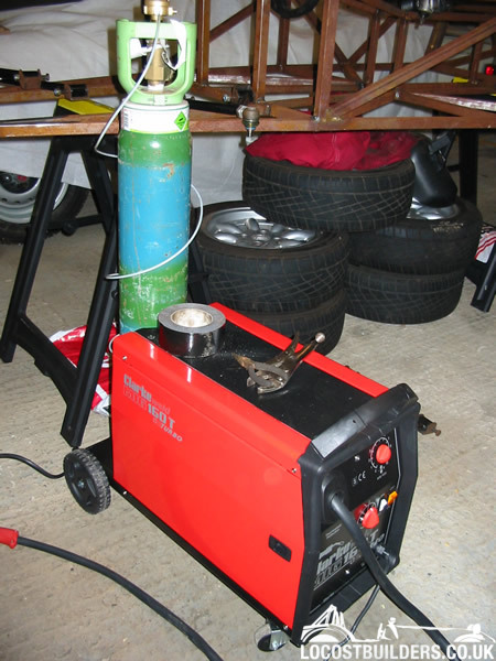

can't remember ever having had a birds nest with my clarke 160t:
http://www.locostbuilders.co.uk/upload/IMG_0795.jpg
beware, I've got yellow skin
