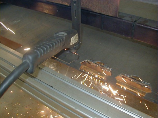

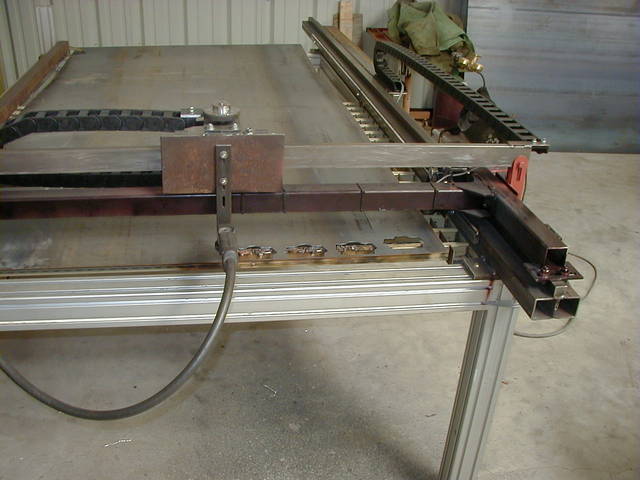

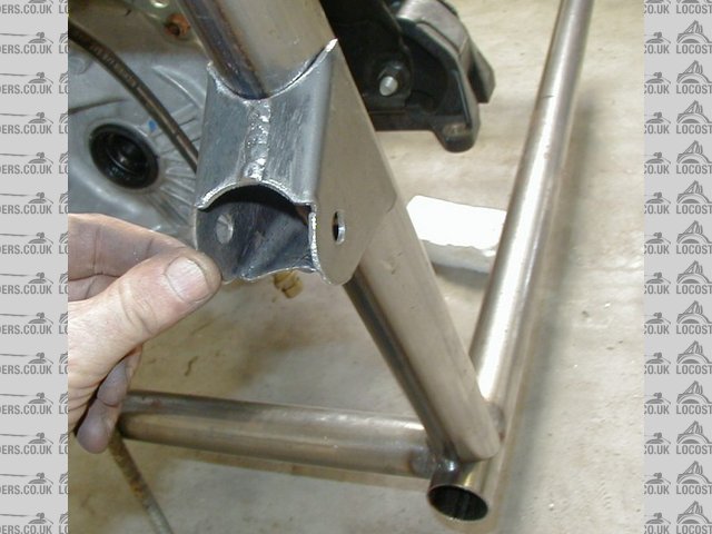

Got my plasma up and running
Some pics of the machine and some parts. It went together well, I very pleased with it.
Alan
  Plasma 1
  plasma 2
  plasma 3
  plasma 4

you built all that to make your brackets.
I would have just used an angle grinder

Alan B
| posted on 11/1/07 at 09:10 PM |
My design will use a LOT of brackets....trust me...LOL
Seriously, the need to make brackets much quicker than by hand WAS the motivation....the ability to use for other stuff was the justification for the
investment.
Time wise it took about 40 hours to build and within 1 day I've probably saved 20 hours work on the parts I've made so far.
| posted on 11/1/07 at 09:16 PM |
how did you automate the trigger? was it hard to make it time correctly?
tks
| posted on 11/1/07 at 09:50 PM |
mhh
looks good altough "lowost"
only thing i would make was like a schock absorber idea for the plasma head (Z axis) in that way it basculates when needed and keeps be pressed to the
sheet. in this situ it will try to lift your Y axis
anyway looks the dogs ....
if you can make more pics! i'm def interested since i'm into this kind of things to.
wich software do you use? Mach 2 /3 ??
Drives? motors?? Servo or stepper??
Tks
ayoungman
| posted on 11/1/07 at 09:59 PM |
Congratulations. I assume its based on an XY plotter type design. Good job.

| posted on 12/1/07 at 12:10 AM |
If you can cut one one way up and the next upside down and get them closer together you will save a lot of material, does the program allow for this?
Alan B
| posted on 12/1/07 at 12:58 AM |
Thanks guys good feedback..
Joel:
No timing issues, the CNC code gives a start signal I just had to interface it with the torch trigger...not too hard.
Tks:
It really should not touch the metal ideally. The object is to keep it around 1 to 1.5 mm away. It is possible to use current feedback to move a Z
slide and maintain the gap....for me it will be mainy smaller parts in thicker material hence not much surface variation. The kit was from torchmate
who use the flashcut software...doing it again I'd know what bits to use and buy them seperately....this time round I was trying to save time
and money..next time I'd save even more.
ayoungman:
I guess it must be a lot like a plotter....
Middy Tim:
Same here, that's why all the electrics came as a package...there was a bit of head scratching but it was mostly plug and play.
Peteff:
There is an extra program that will do the optimised nesting, but you can do it yourself....in fact I was experimenting with that earlier.
