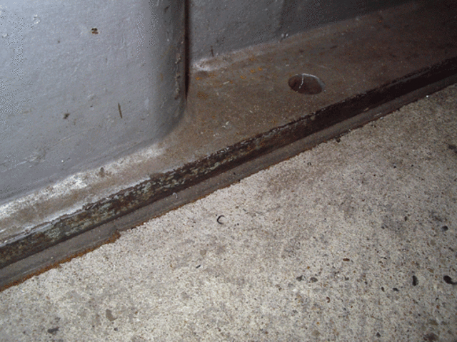

907
posted on 20/1/07 at 05:17 PM Reply With Quote
Forgot to mention, the most important thing with the carpet tiles is colour co-ordination.
You'll note how the silver of the lathe blends nicely with the dark grey of the carpet backing.
The contrast of the orange pile leads the eye to the subtle shades of the concrete.
The accumulated dust gives a "well used" feeling.

posted on 20/1/07 at 05:25 PM Reply With Quote
What amazes me is that there are bolt holes in it to hold it down, as if it's going anywhere in a hurry
posted on 20/1/07 at 05:28 PM Reply With Quote
My lathe has bolt holes - but the manual states that they should only be used when really necessary, e.g. in a ship's workshop! Probably a good idea, as a 1/2 ton lathe sliding around the deck doesn't sound very safe...
[Edited on 20/1/07 by David Jenkins]
