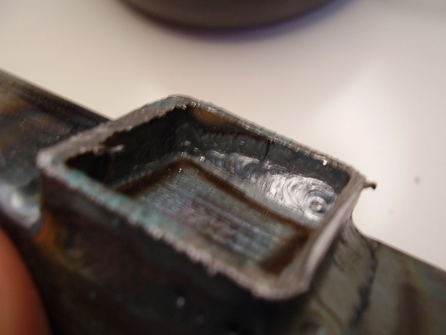

My TIG is here too! Trials are promising.
I won one of the Rehmann TIG160 units last week (Friday) and it was here on Wednesday. All as advertised - top service.
From the first arc I struck I could tell that TIG was for me, at last I can see a proper weld pool! Hello instant and controllable weld pool. MIG is
too quick for me.
I haven't got any filler rod and only a mini bottle of argon so the trials were limited but all seems well.
I didn't really have a clue on set up, it was all done one 55 amps, gas was a hiss, 1.6mm gold end (universal?) tungsten, pressure was a bit of a
hiss. All this was done on a 5 amp fuse as that was all I had.
One of the things I really like about the unit (apart from the price ) is the length of the power and torch leads - the welder can live in the
middle of the garage and the torch can reach all around a chassis. Great for those weld one side then the other distortion cancelling moves.
Obviously I need proper gas, filler wire and LOTS of practice but I am pleased with the operation of the machine and the process.

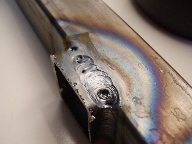

Here are some pictures, no filler rod but it is a weld.
Dont really know what all this aero is about, seemed to be worse when I held the weld pool to long. Hardly worth worrying about at this stage with
such a ropey set up.
Penetration is there if a little blurry.
I think this weld is exhibiting something called 'tungsten inclusions'.
Big thanks to 907 for your help thoughout the should I, shouldn't I process and to the_fbi for buying one in the first place - a good move I
think.
Confused but excited.

Gas with hiss, that will deplete your bottle quickly, you need just a tad of gas to protect the work so keep turning it down to a whisper.

I couldn't really hear the hiss over the HF start noise so I just turned it up and it seemed to work.

On steel about 5 or 6 LPM of gas flow should be a good starting point.
MiG wire ( if you have some ) will be fine to use as well. But can be a bit of a hassle making it straight.

think about the fact that the more time you take the more heat is in your peace and thats often for a chasis not good.
thats the reason that mig is more often used because its faster and "colder"
also think that if you don't apply rod, you eat meat away and your welding HIGH isn't much.

Considering you didn't use filler wire that is a cracking first go with a Tig.
When you get some, you will find that those little pin holes will no longer be a problem.
