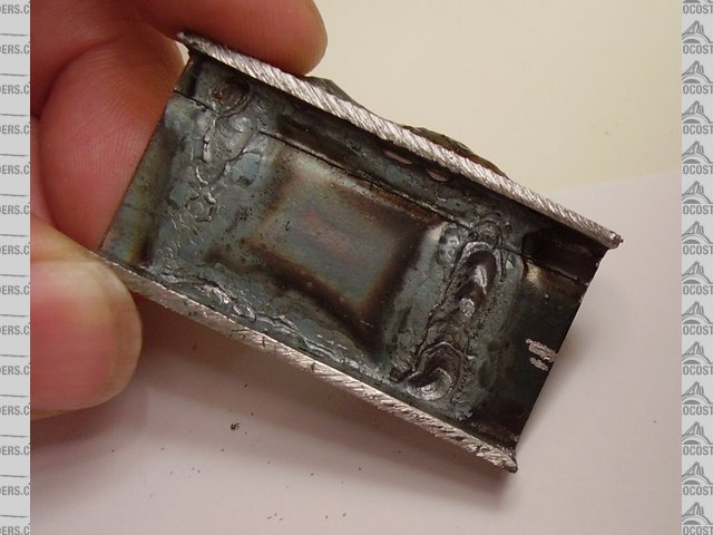

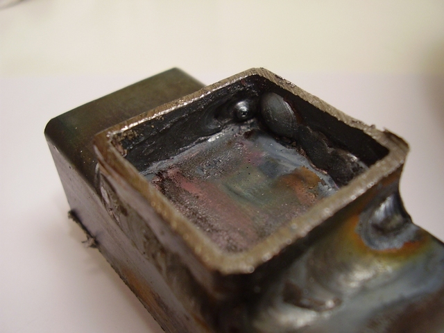

Back to the welding, I seem to have a phenomina I am calling reverse undercut. What is that all about then? I can see it happens to the bit that is getting the most melted but I dont know why. On the first two pictures the nipple at the end of the run goes through both sides. I know that is significant but I dont know why, am I going to slowly for my current setting?
I am slowly making progress, I am venturing around the corners now although there are no pictures of a good one to show you. I can also tell when the tungsten has balled because the arc wanders all over the place.
EDIT - the pictures are in the following sequence:
Outside of butt weld 1
Inside of butt weld 1
Outside of butt weld 2
Inside of butt weld 2 (the really bad bit to the right of the picture)

Them welds look good by the way. Nice and neat and lok like theyv penatrated well.

Looks like to much power not enough rod
