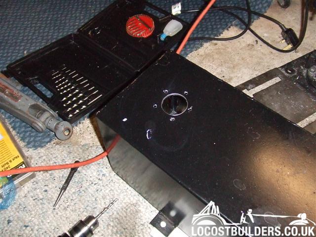

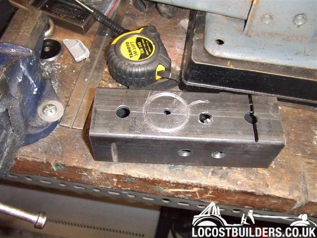

I had a go at fitting a sender to the fuel tank I bought off Martin1973 on here a while back. I haven't used a hole saw before so first I thought
it would be best to practice on some scrap. The hole saw seemed to turn in a slightly eccentric manner in the drill and it didnt go away no matter how
I placed it in the chuck. It seemed to cut ok though if a bit slowly and with a lot of noise and movement from the pillar drill.
£30 Aldi drill and £3.99 (or was it £4.99?) Netto hole saw
Close up.

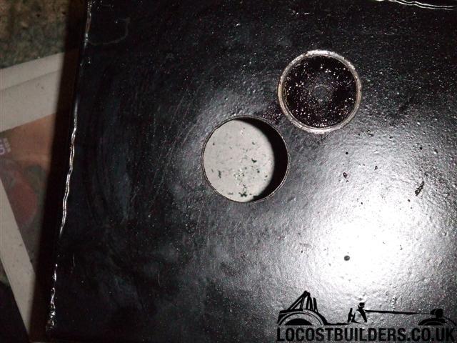

I was very pleased with the cut. I had read up on a few posts on here and used plenty of oil to lubricate the hole saw. The only way to clamp the tank
into position was to kneel on it. (I stood the drill on the floor.) It wasn't going to shift with all my weight on it.
The tank is a bit of a beast as the steel is a little over 2mm thick. Should be fairly safe if not light
I was a bit fortunate with the positioning of the hole as there are two baffles in the tank at third intervals across which I wasn't aware of. I
had about half an inch to spare for the pivoting arm on the sender to go through it's full range of motion
Holes drilled for sender
Sender and Cork Gasket
Result
