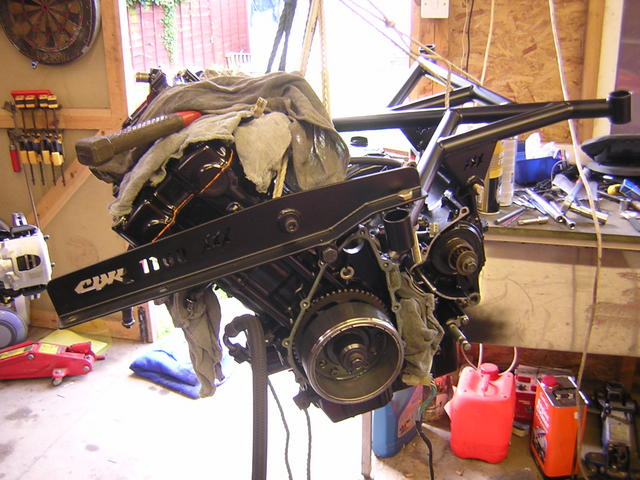

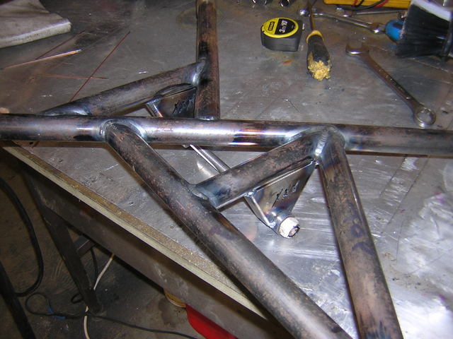

| posted on 16/10/08 at 07:27 PM |
this is my homemade blackbird top engine brace,like mentined before take your time to get your joints nice and tight and you'll pi** it

IDONTBELEIVEIT
| posted on 16/10/08 at 07:29 PM |
steady as she goes

IDONTBELEIVEIT
| posted on 16/10/08 at 07:31 PM |
all painted up

02GF74
| posted on 17/10/08 at 06:36 AM |
nice welds and avatar.
that is TIG welding innit?
nitram38
| posted on 17/10/08 at 09:35 AM |
Yeah, very BIG Tig welding.........
