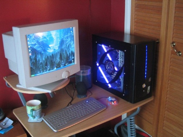

Hi, i recently bulit my pc for undr £400, i chose the Amd64 cpu (only a 3200 but still fast!) i chose the best motherboard going by reveiws and spec
at the time was a Asus K8V-SEDeluxe, a matched pair of Crucial 512 PC3200 memory, a middle of the road graphics card (about £50 for a saphire
256mb)and a case with side window and lots of uv lights and a 600w psu. I used my old hard drive and it works a treat! Would definately do it again,
may not be any cheaper but its built how i wanted and you get the satisfaction of knowing you built it

Nice computer Ben, might look into components (or similar) you used.
Didn't realise the power packs had got so powerful now and needing it. Will make sure i look at getting the right one.
