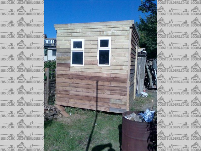

Hello all,
Ever sinse I started my build I have had a big problem, the garage was only just big enough to get my car in so by the time I had stuffed it full of work benches, tools, lawn mower etc there wasn't any space left for the chassis and other bits so most of my kit has been stored in the loft and under the stairs etc.
But now I have finished my workshop and all the crap can go in there making room for the car. YES!
What do you guys think of the Shed/Workshop? Its 8' x 8' x 8' tall, the whole thing is sat on 4 stilts with the floor raised 1' off the ground.
The stilts are 4" x 4" fence posts with a 2" x 2" frame work and 3" x 2" floor and ceiling joists. 18mm chipboard floor. 18mm MDF flat roof with a layer of GRP to waterproof. Rescued attachment Image072.jpg

If you're like me, your shed will fill up magically before you can transfer anything from the garage and you will end up with two unusable spaces
