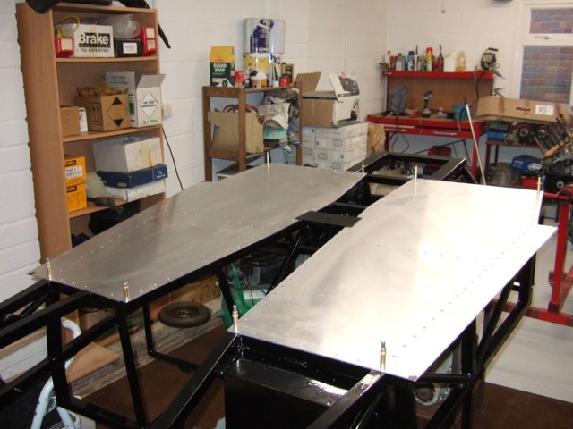

Hi thought I would update this thread, still not a lot of progress made I'm afraid.
Had a lot of building work done, including making my garage twice the size
So
Chasis comes home
Got the chassis home from my sisters garage into my new carpeted garage
Build tables
Made some build tables
Chassis on build tables
and put it on
Floor pans drilled
Drilled floor pans ready for fitting
Will turn it over and drill the transmission tunnel panels before I fit them though
It's so good to finally be able to start putting it together
Mark
