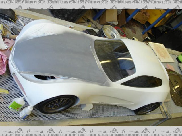

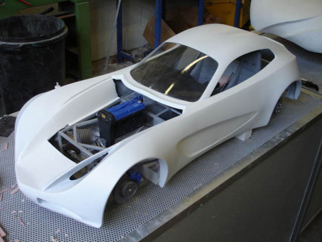

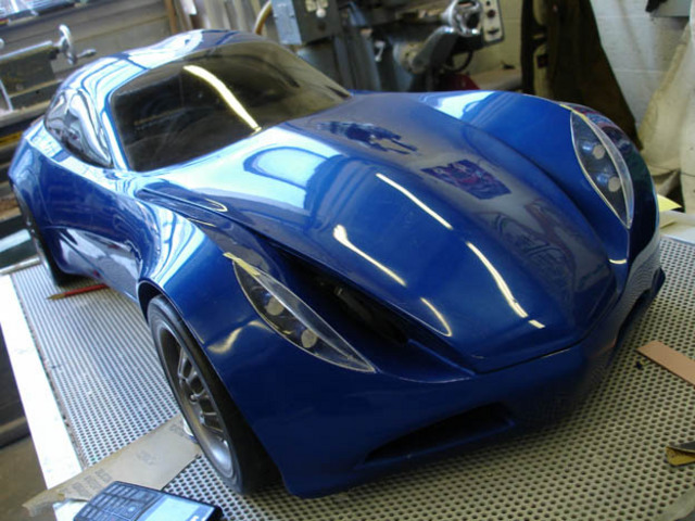

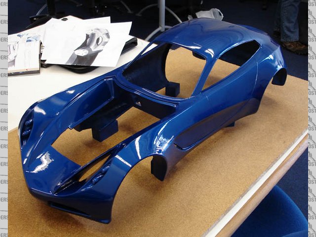

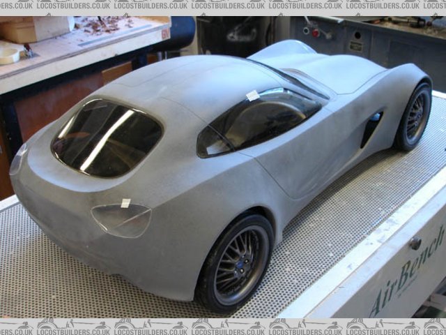

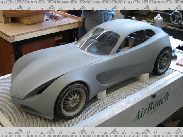

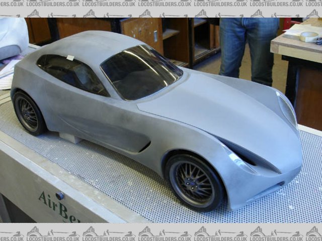

The clay model is finished and ready for molding, i have backfilled as many undercuts as possible and built the bottom of the model down to the base
to leave a nice surface for the fibreglass.
GAZ
BLOODY HELL!!!! that is awesome
What the hell is it?
Will it fit a locost chassis...

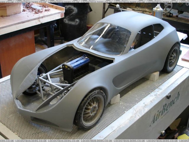

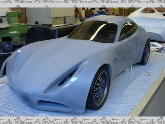

I decided that it would be necessary to make a four part mold and inserted thin plastic sheet into the model so i would be able to produce a
flange.
The mo;d material is called 'Polydur' its a bit like a cross between fibreglass and plaster. It comes in a kit form with most things you
need.
GAZ

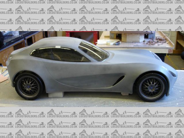

That looks fabulous. Are the gaps between the front wheel arches and bonnet for the lights or are they vents?
Here we have one side of the mold layed up. Thanks to Rob for giving me a hand.
Thanks for the comments chaps , they are comming quicker then i can put the pics up.
They are vents by the way, this thred is a continuation from (locost exterior design)

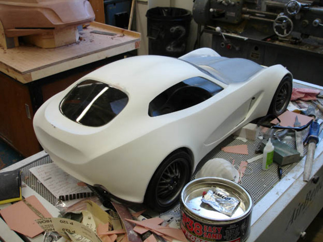

Now got both sides layed up. i have the front and back to do tomorow. And fibreglass on monday.
any questions feel free to ask.

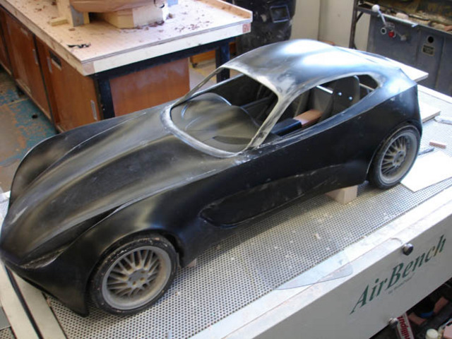

Is this mould designed to save the clay buck or will it have to be damaged? Are you sure that front will draw in one piece?
Hope it all works and survives, would be a shame to see it damaged.
Out of curiosity did you do anything to dry the clay?
On a serious note... (and thats rare from me!). You planning on making a short run to pull back costs of manufacture/ insaurance?
When i say clay, thats a bit of a fib. In the car industry it is known as clay but it is more like plastercine. When you warm it, it goes soft, as
it cools it goes hard.
As for the model being damaged, it most likely will get a good beating.
I have filled the front vents in a little and have covered the thing in release agent so with a bit of luck the mold will come off. The worse thing
that can happen is the clay will be damaged. The condition of the mold is the important thing.

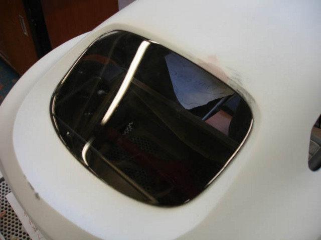

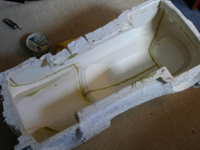

i got the other two parts of the mold done today
It took a while, alot of sweat, a few harsh words but the mold came off.
I just need to clean the mold and polish it and it will be ready for fibreglass.
as for the clay model it had a bit of an accident...........A BIG ONE..

I certainly hope you properly evaluated your plug for negative drafts before laying out your part lines! The slightest negative draft will ensure that your fiberglass remains in the mold.... until something breaks or is stress fractured.
Thanks Steve, The damage to the model was caused but the clay sticking to the gel coat even though the model had tonnes of release agent on it, I
think i was sold the wrong stuff. It should release ok but i will find out in a few days time. I have to send the mold off for fibreglassing because
due to the wonderful world of health and safety i am not allowed to use fibreglass at the university.
GAZ

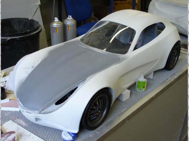

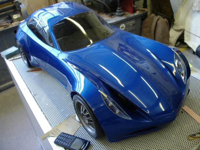

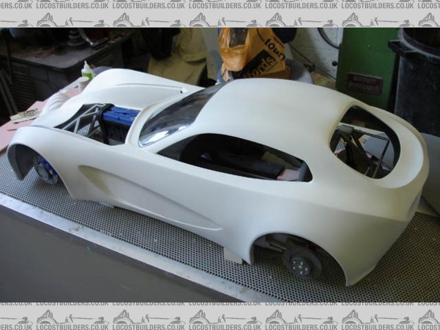

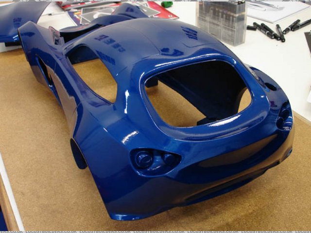

I have now finished the mold, I filled the gaps inbetween the different sections with milliput and given the mold 8 coats of mirrorglaze.
I will drop it off tomorow and pray
GAZ
Fingers Crossed.

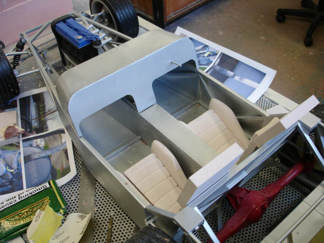

While the body is away it thought i would spend a few days building the seats.
Should be finished tomorow

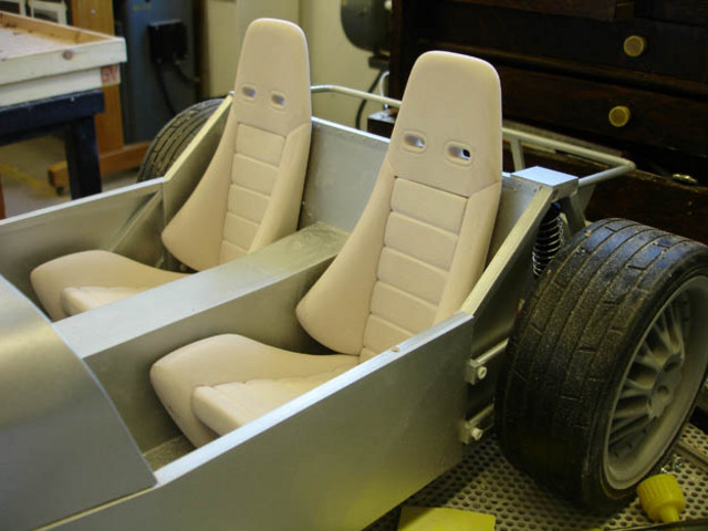

Here are the finished seats, minus a bit of piping.
Thanks GAZ
Thanks for the comment JamJah, you have a good point. The same point was discussed with the exturnal examiner. My argument to defend it was along
the line of.
The people who i would be selling the design to would not be desingers and i wanted there to be recognisable componants to show that it is a fesible
project grounded in the real world. (hence the scale chassis etc)
The model its self has to be a compromise between appealing to the designer and the public. Although the model will have opening doors, bonnet etc,
when the model is displayed all these will be closed and there will be a little tint to the glass.
Thanks again for the comment because it is a cracker.
Hi Gaz
The seats look good.
Watching each new bit being added is like a full size build.... quite exciting.

The fibreglass shell is not ready to be piced up until tuesday so i have done a bit more on the interior.
all comments gratefully received
Piping the seats is just showing off

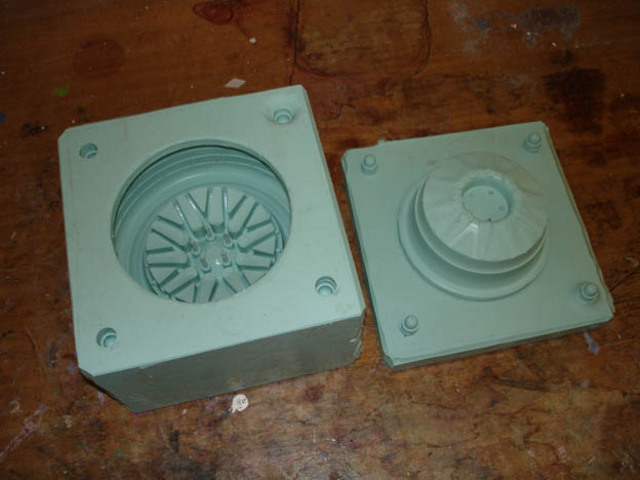

Here is a pic of the early wheel design

I got the fibreglass back this morning, and with a little swearing got it out the mold. I have started to tidy it up.
I need to do a little work to get the body sitting in the right place but it is close, It need to drop about 5 mm all around
Looking nice. Looking very nice.
You going to supply clean underwear at the exhibition!!! hehe
Well done. I really like that!
First order for a full size please!
Thanks to everyone that has followed this project and all the comments so far..
GAZ
What did you do with the derier in the end? Got an pics of the rear 3/4?
What a plumb i am, i only took one and its not great, it looks odd without lights (as does the front) I had better take some tomorow.
GAZ
Looking good.
Started rubbing down the fibreglass today, i didn't realise how bad bit of it was, i needed to finish the clay a bit better me thinks.
There are some strange dips in the body shell that dont appear to be in the mould, is it possible that the gel coat lifted away from the mould?
GAZ
I say no, it may have been taken of the mould a tad to early as it takes a couple of weeks for it to harden, a common problem. If the gel coat
separated it would look dreadful (really) and the gel coat takes stays softer for even longer than the mat. Don't put to much pressure on it when
sanding and best to use lightweight filler like red devil (model shop). It's not so bad as remember that although the model may be 1/4 scale all
the blemishes and flash lines are full size

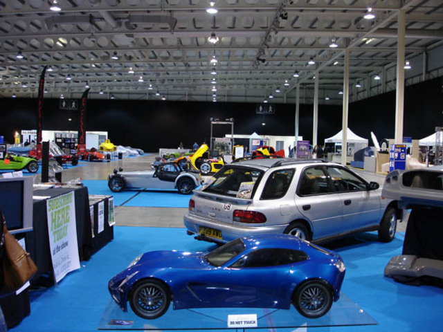

For anybody who is interested and able to go, I have today received confirmation of a space at Stoneleigh to display my model/design.
It will be on the Complete Kit Car Magazine stand on Sunday and Monday.
Thanks,
Gaz

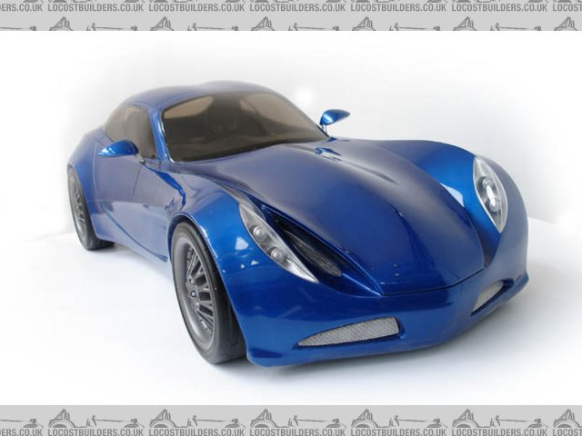

I gave it a quick coat of satin black just to show up all my cock ups. (the joy of rubbing down)
Test pilot ted has made a comeback, but only for ergonomic data, I need to move the seats forward as his legs don't reach the peddles. (come to
think of it I still need to make them.)
Thanks again to everyone.
GAZ...
Damnit, that's some nice work there.
"There are some strange dips in the body shell that dont appear to be in the mould, is it possible that the gel coat lifted away from the mould?"GAZ
I don't know looking at that pic with teddy in it that finish is really nice.

Today i ran a test vac form of the windows and all went ok ish. The finish is crap but that, i think is down the fact i used the wrong plastic. we
had none in stock. But it fits ok.
Also started on the interior the dash is rough and needs alot taken off. You should get the idea.
and here is the dash
and from the back...
Thanks again for all the comments and look forward to putting some faces to the names at the show.
GAZ

Car is looking great! Have you given much thought as to how to display it at Stoneleigh?
I have a few tiles left over from my garage floor if you want something for it to sit on, rather than just a table cloth.
Tiles are a matt grey rubber, with raised dots on them, 600x600mm.
As seen underneath my car
Back Right]
Just let me know if they would be any use to you.
Mike
thanks mike,
I'm ok thanks, Ive got the use of some glass display stands from the uni.

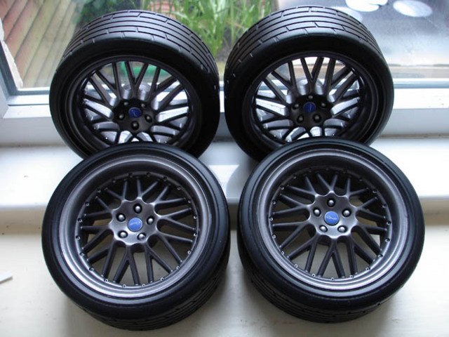

Nice Tyres by the way, what are they?
And dad if you read this, no they are not going on the A2, Thats the car not the road.
GAZ
R888's
You know they make sense!
Mike

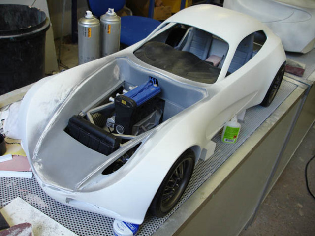

Been working on the body today, cut the bonnet out and got that fitted. I still need to sort air vents and fixing to the chassis but i'm getting
there.
One with
One without.
Thanks chaps
GAZ
That car just keeps on getting better and better! Astounding piece of work there that man/team!
(insert a we are not worthy smiley here)

Finally room for a big radiator
Looking great, as usual. I like everything so far and would personally prefer the shell to extend down onto the chassis in the engine bay like this

mr whippy, You meen like this.
I will get the back of the engine bay done on monday.
Gottabedone, thanks for the comments. I would love a company to take the project on as long as i still had imput on the developing design and the deal
was right.
We shall see.
GAZ.
ps. Just a thought does your name read
gotta be done or gotta bed one?????
Sorry about that.

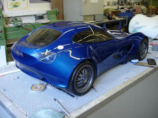

Originally posted by Gaz 1977

Having just gotten back from the show, anyone that missed Epona missed out on an absolutely stunning model! The pics on here don't even come close to doing it justice. Was good to meet the man behind the model and have a chat. I'm still struggling to find much in the way of criticism, but will have a think, as he needs both good and bad comments for the final report!
Ditto the above, very very nice model and design.
Criticism? On the model I have none, on the design, well the nose is very long (longer even than a seven) which is going to make getting out of some
junctions that have poor visibility tricky, also where do you put your luggage?. But to be honest that's about the size of it.

STUNNING.
I realy hope you have had some positive feedback from manufacturers at the show?
STUNNING.
Well Done, from one proud dad.

thanks chaps,
I had a great show, a great turn out. Its been good to meet a few of you.
The car looks better and better every time I see it...

Took some pics of the thing today,
here you go
and here is another
Thanks for all the comments chaps
gaz

I have finally got some new stuff to show on here.
I am part way through a revised side view of the design, its hard to spot the differences but feel free to have a go.
all comments are very welcome
Gaz
I think I'd like to keep the rear 'quarterlight' behind the door, as visibility is difficult in that direction on my open locost -
blocking it off would be a nightmare on slip-roads!
I appreciate that it would be a pig to produce, though.
It would appear that you have shortened the front over hang personally I prefer the old view. where do I apply for the prize

finally i have finished the revised side view of the Epona.
the changes are as follows.
Front arch enlarged
wider wheel arches
narrower side vent
additional side skirt
larger door
simpler glass area
slightly higher roof
larger lips on arches
All comments greatfully recieved
GAZ
