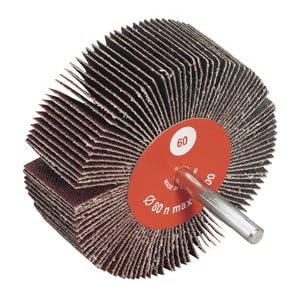

I'd go with a flap wheel and patience, you should be able to touch the edges in, or use a trim.
