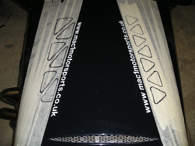

At Stoneleigh the under bonnet temps after a motorway blat caused me some problems. I need to have more vents? Im not an expert on what looks nice.
Please show me yours?
Here are some ive sketched on my bonnet. Constructive comments very welcome. i will have the same on both sides so which do you think look best or
what else would you do? My idea is to put mesh behind just like infront of the bulge.
I think im favouring the rh side set but perhaps only the front 4.

muzchap
| posted on 3/5/06 at 09:02 AM |
Personally I prefer the ones on the right.
Or whats wrong with 2 long strips with rounded ends? That'd look good - especially if you follow the lines of the bulge

Hellfire
| posted on 3/5/06 at 09:11 AM |
I think further back as when you are moving quickly the hot air is being pushed towards the rear of the engine bay and down the tunnel not along the
top.
If you do put them there the underneath will need significant reinforcing as it seriously removes any rigidity in the otherwise flimsy to start with
bonnet.
The ones on the right I prefer.

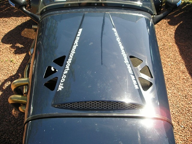

Good suggestions so far. Main reason for the vents is to get cool air into the carb air filter (filter is currently 60% covered by the bonnet which is
pressing down on it = high underbonnet temps and fuel vaporisation problems that i experienced at Stoneleigh) hence forward location. I dont want a
normal air filter hole as i plan to fit bike carbs for which i will need a hole in the side for eg a pipercross filter to poke through. Im designing
the vents on both sides to balance the look for when i no longer have the downdraught fitted.

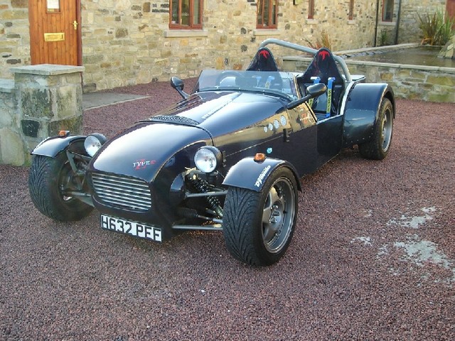

I also have vents in side of the bonnet at rear which have helped air flow a lot as shown here.
I also share your concern over compromising the bonnet strength hence why im thinking of adding the ali mesh underneath as with current vents. Iam
also concerned about how neat i can cut the vents with my rotozip.

DarrenW
| posted on 3/5/06 at 11:01 AM |
Waht about this as an alternative idea?
Im not 100% confident of being able to cut all of the traingles neatly using the rotozip but i do have a set of hole saws. So perhaps replicating the
4 holes in the side but with a smaller set on the top, starting small at the front and then progressively getting larger, but as said smaller than the
side set.

Ive done 3 tringular vents on each side of the bonnet bulge tonight. Dead easy with rotozip - just slowly slowly steady away and clean them up with
file and emery tape. Just need some mesh now to finish off.

DarrenW
| posted on 5/5/06 at 10:17 AM |
Here are the bonnet vents - just need some mesh to go in.
