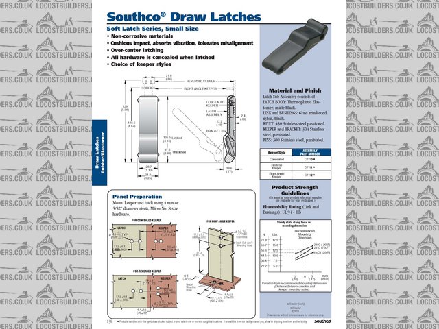

Anyone got the spec sheet that comes with the CBS SVA rubber bonnet catches showing the distance between top and bottom?
Since getting a new body tub I'm not sure where to put the catches back on.

I think this is correct!
Rubber Catches
Rubber Catches

Thanks Mike, just the job, the bonnet is secure once more!
