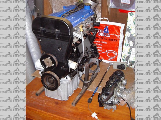

Hi Keith.
Gaz hasn't got an Internet connection yet but...
AFAIK he's been doing a mod or two on Photoshop and a few bits & bobs have appeared in my garage.
At least some kind chap made a handy stand for the engine.
Atb
Paul G
(aka Dad)
[Edited on 26/8/07 by 907]

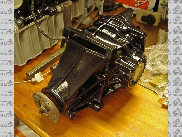

Gaz 1977
| posted on 1/9/07 at 02:13 PM |
paint pics
well i've been painting this week, I used plastic coat zink primer and plastic coat metal protect top coat. I was pleased with the way it went
on, and it has a really good drying time (about 40 mins)
Reconmended!
I got hold of some ZX9R carbs and have sent them off to Bogg Bros to have the manifold sorted, I have know idea when i will get them back, If they
look as good as the pics on their website i will be well happy.
I started grovelling to farter, and with a bit of luck there might be the beginings of an exhaust manifold soon.
I will stick some pics of the revised design on here in the week.
Gaz

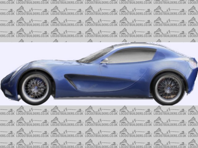

Gaz 1977
| posted on 8/9/07 at 02:53 PM |
revised design

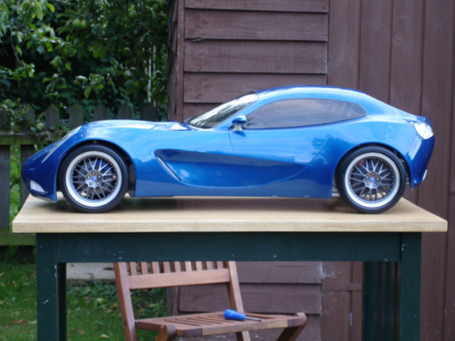

I have finally got some new stuff to show on here.
I am part way through a revised side view of the design, its hard to spot the differences but feel free to have a go.
all comments are very welcome
Gaz

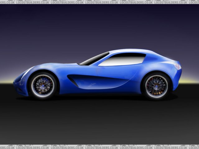

Gaz 1977
| posted on 8/9/07 at 02:55 PM |
revised side
and heres the one to compare.
I need some good ideas on which wheels to use, i cant make my mind up.
Gaz
| posted on 8/9/07 at 03:11 PM |
I think I'd like to keep the rear 'quarterlight' behind the door, as visibility is difficult in that direction on my open locost -
blocking it off would be a nightmare on slip-roads!
I appreciate that it would be a pig to produce, though.
dnmalc
| posted on 9/9/07 at 07:15 PM |
It would appear that you have shortened the front over hang personally I prefer the old view. where do I apply for the prize
oadamo
| posted on 9/9/07 at 09:21 PM |
this is looking really good now i would put somthing like OZ Canova wheels or lenso granso on this you need some that will stand out as i
think that the wheels make the car.
[Edited on 9/9/07 by oadamo]
JamJah
| posted on 10/9/07 at 06:26 AM |
No. You make the car. Gaz makes the body.
The wheels just make it look smart. hehe
This is personal advise or personal opinion.
Constructive comments gratefully recieved, picking is left for noses.
JamJah
| posted on 10/9/07 at 07:50 AM |
  EPONA - model on top
Model 50% transparent on top of rendering.
  EPONA - render on top
Render 50% transparent on top of model.
Differences i saw...
Half window, already mentioned
Wheel arches?
Loss of wing mirror.
[Edited on 10/909/0707 by JamJah]
JamJah
| posted on 10/9/07 at 07:59 AM |
Steeper rear window?
Gaz 1977
| posted on 10/9/07 at 11:41 AM |
revised design
thanks chaps.
Sorry forgot to put the mirror on,
well spotted everyone,
the front over hang is one of the few part that i havent touched, it is funny how when you change different parts other parts seem more apparant or
seem to change .
any chance of a few pics of those wheels

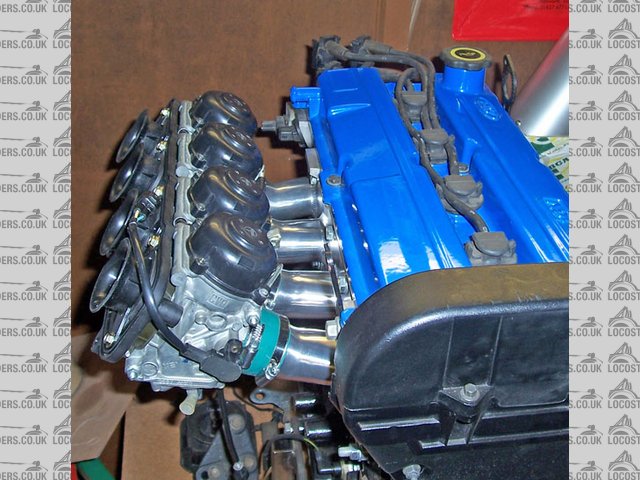

| posted on 6/11/07 at 07:55 PM |
Shiny bits arrived
Hi All.
Gaz has had "the call of the curry" so I'm posting this on his behalf.
The inlet manifold & carbs came back from Bog Bros yesterday so we've hung them on the Zetec
and thought you might like a pic or two.
We are well impressed.
Paul G
907
| posted on 6/11/07 at 07:59 PM |
A mouses view.
907
| posted on 6/11/07 at 08:01 PM |
The internals are also finished well.
Paul G

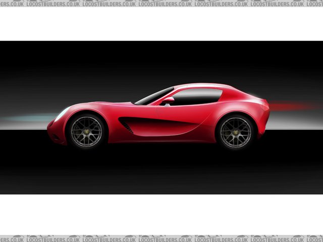

Gaz 1977
| posted on 3/1/08 at 09:01 PM |
revised side
finally i have finished the revised side view of the Epona.
the changes are as follows.
Front arch enlarged
wider wheel arches
narrower side vent
additional side skirt
larger door
simpler glass area
slightly higher roof
larger lips on arches
All comments greatfully recieved
GAZ
RazMan
| posted on 3/1/08 at 10:01 PM |
Looking really good Gary.
One observation - have you allowed enough clearance for the headlights when the steering is on full lock & bump? I mention that because I had the
same clearance 'challenge' when I designed my front section, which required a little rethink quite late in the buck production.
I am not sure which lights you are planning to use but it might be a good idea to get the tape measure out
[Edited on 3-1-08 by RazMan]

Gaz 1977
| posted on 4/1/08 at 03:51 PM |
revised side
thanks for the idea Mike.
Consider it done
Gaz
