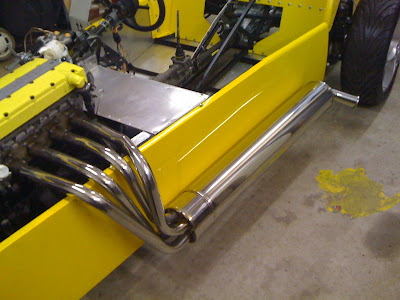

| posted on 16/7/10 at 06:03 PM |
With pics!
Pics, not quite finished but i'm sure you get the idea....
Thoughts?
[Edited on 16/7/10 by franky]
fha772
| posted on 16/7/10 at 06:19 PM |
Ooooooooooooooooooo, I think i may have just embarassed myself
That is a stunning bit of work!!

40inches
| posted on 16/7/10 at 06:27 PM |
Thoughts?
Good luck fitting the side panel

dlatch
| posted on 16/7/10 at 07:27 PM |
looks wise i am really not liking the way that one primary runs
just looks wrong to me although sure its great for flow just astheticly it lets a otherwise stunning system down
sdh2903
| posted on 16/7/10 at 07:31 PM |
Thoughts?
Thats a point, any ideas on how the side panel is going to fit? Is it going to have to be split?

| posted on 16/7/10 at 08:57 PM |
Just cut a hole and slide it along, already worked that bit out. Not that big a hole. That curved one looks nice in the flesh, its just that its
got the shortest run of all so something had to be done and the steering shaft passes through the middle of them all
franky
| posted on 16/7/10 at 09:00 PM |
over 50% of voters would pay the cost Chuffed isn't the word. I had quotes of £1500+ for the same thing! Can't see how it could be
done better with the space and spec

Slightly nervous that your exhaust can is a little small.
franky
| posted on 16/7/10 at 09:40 PM |
quote: Originally posted by MikeR
I never said i'd pay the cost - just what i thought it would cost.
I take it you're being sarcastic!? You can fire trident missiles from it!
