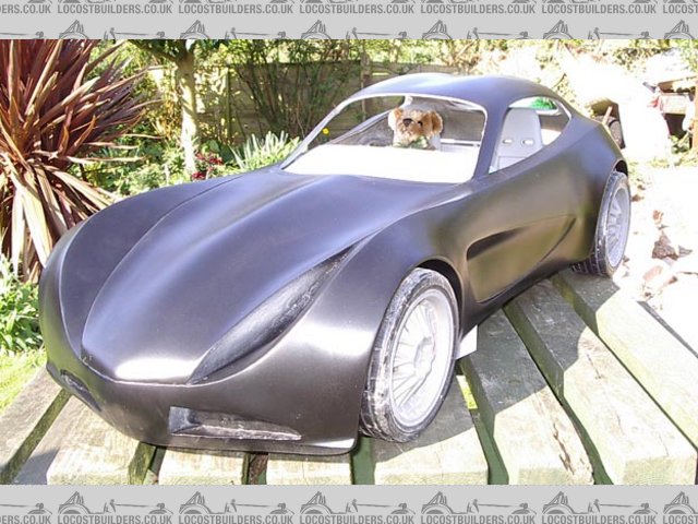

I gave it a quick coat of satin black just to show up all my cock ups. (the joy of rubbing down)
Test pilot ted has made a comeback, but only for ergonomic data, I need to move the seats forward as his legs don't reach the peddles. (come to
think of it I still need to make them.)
Thanks again to everyone.

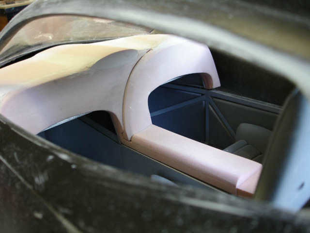

Also started on the interior the dash is rough and needs alot taken off. You should get the idea.
Gaz 1977
| posted on 17/4/07 at 06:10 PM |
epona
and here is the dash

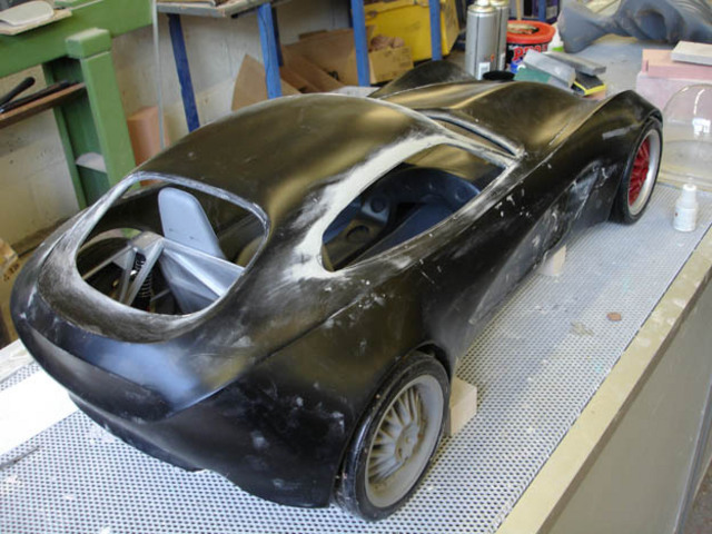

Gaz 1977
| posted on 17/4/07 at 06:12 PM |
epona
and from the back...
Thanks again for all the comments and look forward to putting some faces to the names at the show.
GAZ
