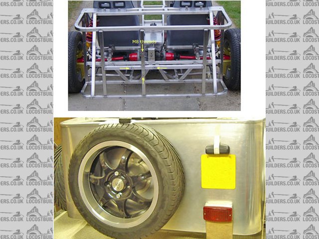

| posted on 20/12/08 at 02:53 PM |
quote: Originally posted by paul the 6th
A lot of people have told me "just stick it in a van, then you've got somewhere to get changed and store all your stuff"....
Actually that's something I meant to ask a while back - are there any plans/measurements/details anywhere on the net for incorporating a spare
wheel carrier into the roadster. I've got the ron champion book as well but can't remember any details for a spare wheel carrier in that
either?
Hi.
When I made my chassis I added a cross between the top and bottom hoops with threaded inserts welded in. (arrowed in 1st pic)
Skinned the back as normal and drilled to match the 4 threaded holes.
I then made up a top hat with 2 wheel studs mounted in it and bolted this onto the rear of the car.
The spare fits on the studs with locking wheel nuts. (see pic 2)
Note the spare is off centre to allow room for a number plate.
If I were to fit a tow ball I would brace my bottom hoop and weld in a plate with 2 threaded holes to match a tow ball.
Plug the holes for SVA and fit the ball later.
It would then be removable.
Hope this helps.
